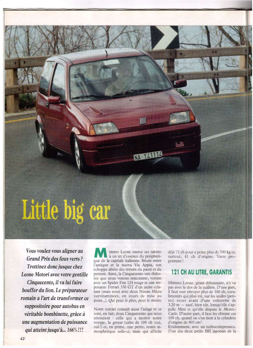

CINQUECENTO LEONE MOTORE TUNING (Italy)
http://1.bp.blogspot.com/_8ukSdy86WJs/SwZ4ZC9cXII/AAAAAAAAIDs/bwqkaYYtzgQ/s1600/cinquecento+900+Leone+305+1.JPG
http://2.bp.blogspot.com/_8ukSdy86WJs/SwZ4Vlif1XI/AAAAAAAAIDk/LYSTiQaGZ7g/s1600/cinquecento+900+Leone+305+2.JPG
http://4.bp.blogspot.com/_8ukSdy86WJs/SwZ4S8dI9TI/AAAAAAAAIDc/I0il_7p0kiQ/s1600/cinquecento+900+Leone+305+3.JPG
http://2.bp.blogspot.com/_8ukSdy86WJs/SwZ4OwsSjnI/AAAAAAAAIDU/RTrPgZxIrjo/s1600/cinquecento+900+Leone+305+4.JPG
http://2.bp.blogspot.com/_8ukSdy86WJs/SwZ4B0KiU1I/AAAAAAAAIDM/EH6YVwriAFA/s1600/cinquecentosportingLeone335c.JPG
http://1.bp.blogspot.com/_8ukSdy86WJs/SwZ39dxnZ7I/AAAAAAAAIDE/jfcdjtRtNqY/s1600/cinquecentosportingLeone3351.JPG
http://1.bp.blogspot.com/_8ukSdy86WJs/SwZ36cmnETI/AAAAAAAAIC8/6pixdibbvjQ/s1600/cinquecentosportingLeone3352.JPG
http://2.bp.blogspot.com/_8ukSdy86WJs/SwZ33ppHuUI/AAAAAAAAIC0/ksT4QvWn8Pg/s1600/cinquecentosportingLeone3353.JPG
http://3.bp.blogspot.com/_8ukSdy86WJs/SwZ3zjaoSzI/AAAAAAAAICs/ifIofsrlfFc/s1600/cinquecentosportingLeone3354.JPG

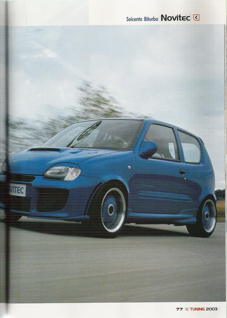

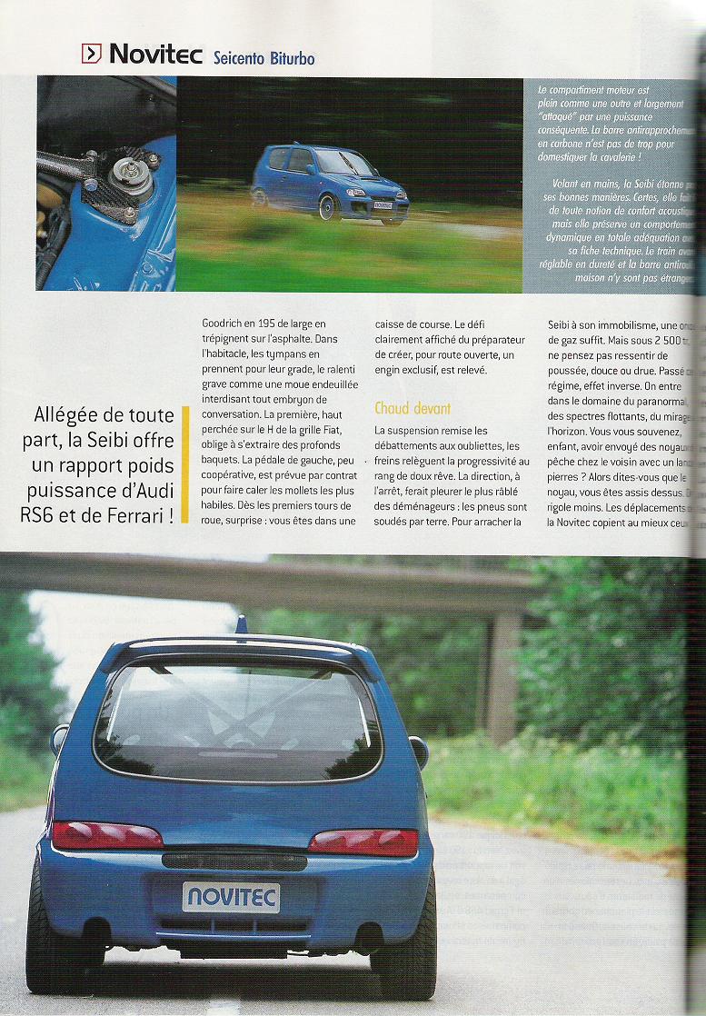

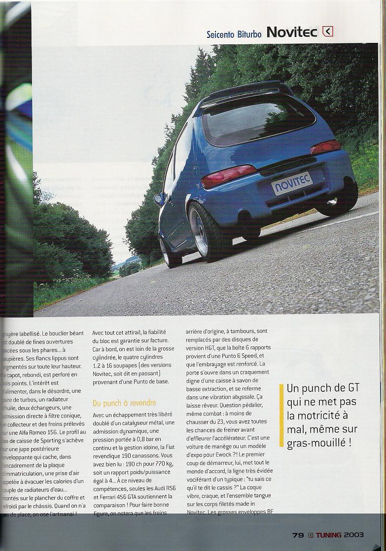

SEICENTO BITURBO NOVITEC - SEIBI (Germany)
http://3.bp.blogspot.com/_8ukSdy86WJs/SwZ2rkBoHcI/AAAAAAAAIB0/dr7SfAoub6U/s1600/Seicento+Biturbo+0.JPG
http://2.bp.blogspot.com/_8ukSdy86WJs/SwZ2oTXYuEI/AAAAAAAAIBs/p_69YkT-3SU/s1600/Seicento+Biturbo+1.JPG
http://3.bp.blogspot.com/_8ukSdy86WJs/SwZ2k6h7AtI/AAAAAAAAIBk/-aEvSANGBVk/s1600/Seicento+Biturbo+2.JPG
http://1.bp.blogspot.com/_8ukSdy86WJs/SwZ2gUBnaMI/AAAAAAAAIBc/xF5SqFiRn5A/s1600/Seicento+Biturbo+3.JPG
http://2.bp.blogspot.com/_8ukSdy86WJs/SwZ2d33CKFI/AAAAAAAAIBU/jtPb5Ns89oc/s1600/Seicento+Biturbo+4.JPG
http://3.bp.blogspot.com/_8ukSdy86WJs/SwZ2aiWUf0I/AAAAAAAAIBM/_K0QLh3AFL8/s1600/Seicento+Biturbo+5.JPG
http://4.bp.blogspot.com/_8ukSdy86WJs/SwZ2WQYazjI/AAAAAAAAIBE/ee7Wote0wnk/s1600/Seicento+Biturbo+6.JPG
